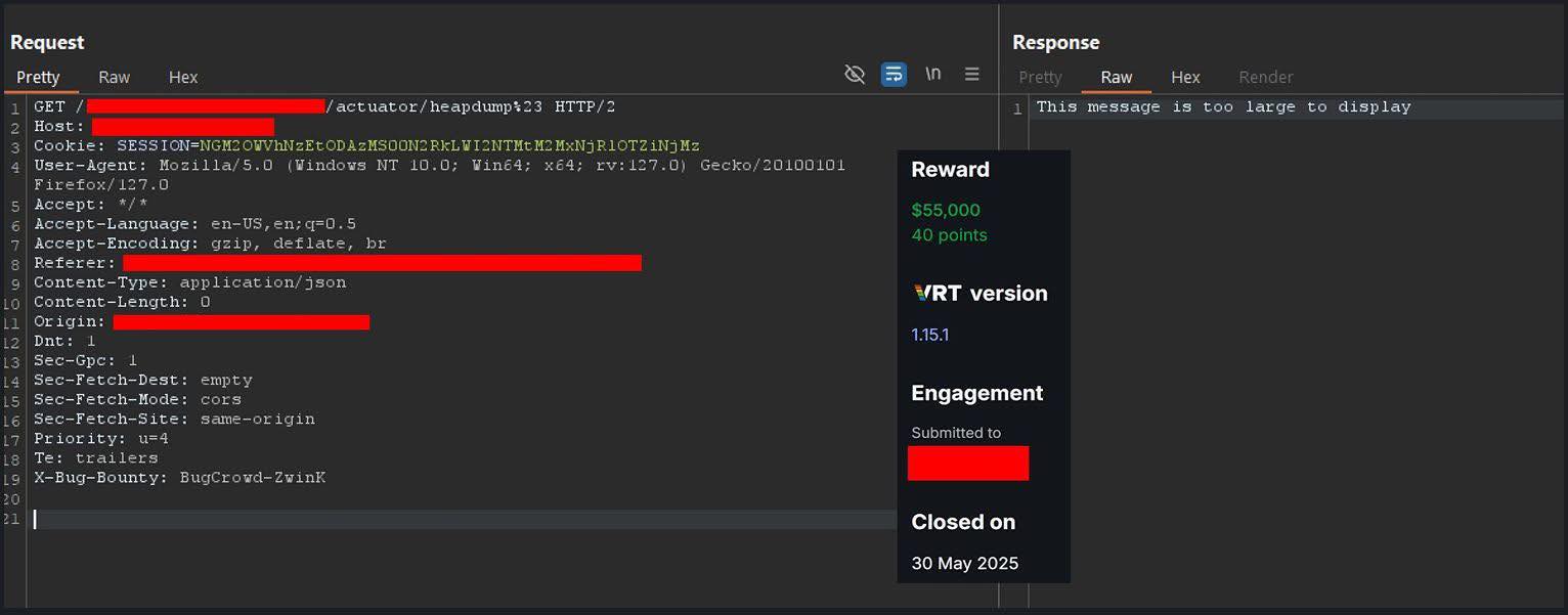

Example of a Dangerous Request 🧪​
GET /actuator/heapdump HTTP/1.1
Host: vulnerable-site.com
If accessible, the server will return a massive memory dump containing sensitive data 🚨
WAF Bypass Trick Using URL Encoding 🕶️​
Sometimes a WAF (Web Application Firewall) blocks direct access to heapdump.
But attackers often try a simple encoding trick.
The Trick 💡​
Add an encoded # at the end of the path: /actuator/heapdump%23
📌 %23 is the URL-encoded version of #
This can confuse some WAFs and allow the request to pass while the backend still processes it normally.
⚠️ This bypass works more often than people expect.
