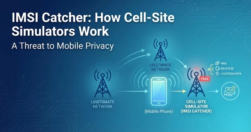

An IMSI catcher is a device designed to behave like a cellular base station so nearby phones may interact with it.
The term IMSI refers to the International Mobile Subscriber Identity, an identifier associated with a mobile subscription. A cell-site simulator can attempt to collect identifiers from phones within its radio range by taking advantage of how mobile devices search for and select available networks.
A simplified scenario looks like this:
Nearby phones
Fake cellular station
Device or subscriber identifiers
Possible location information
Potentially more advanced attacks, depending on the network and equipment
The exact capabilities depend heavily on the cellular technology involved, the phone, and the equipment being used.

How Can a Phone Connect to a Fake Cell Tower?​
Mobile phones constantly search for available cellular networks and select a suitable network to maintain connectivity.
A cell-site simulator can transmit radio signals that make it appear to be a legitimate cellular station. Under certain conditions, a phone may interact with the simulated station.
The security implications depend on the cellular generation being used.
Older technologies, especially GSM/2G, have weaknesses that can make this type of attack significantly more practical than it would be against modern cellular networks.

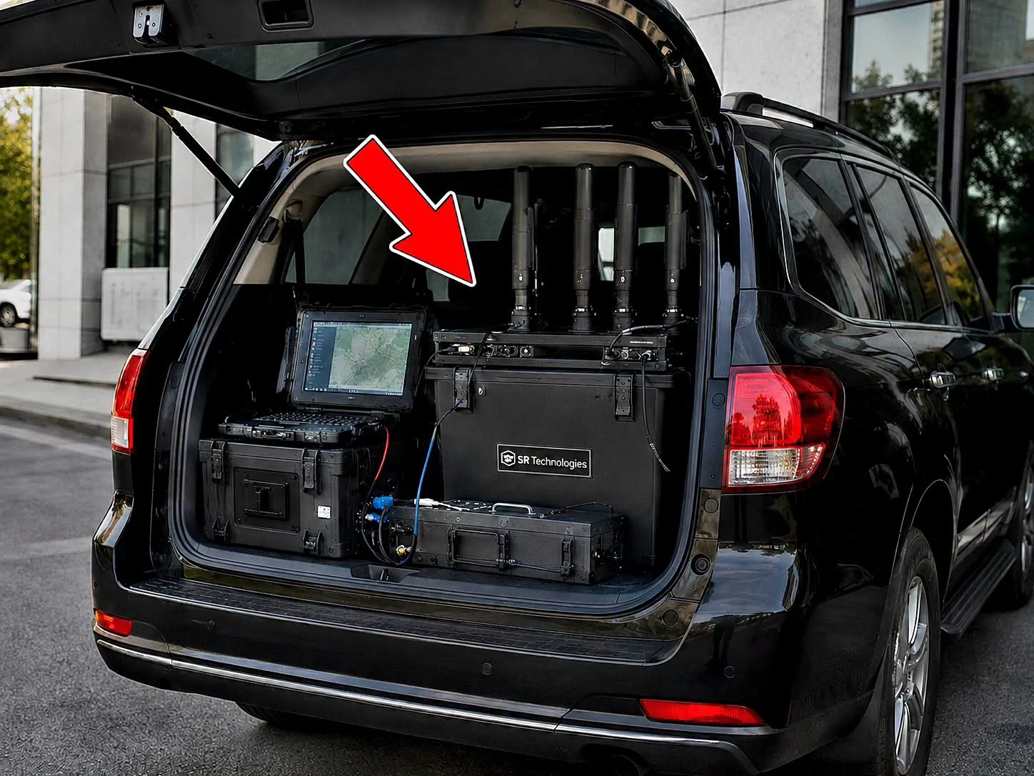

Seeing an unfamiliar piece of hardware does not automatically mean it is an IMSI catcher.
A device containing components such as:
  • RF hardware
  • GPS
  • Ethernet
  • Cameras
  • Cellular antennas
could have many legitimate purposes.
A photograph alone is usually not enough to reliably identify a device's exact model, manufacturer, or capabilities.
If you need to identify a specific device, the model number, manufacturer information, labels, visible interfaces, or other technical details can provide much stronger evidence.
