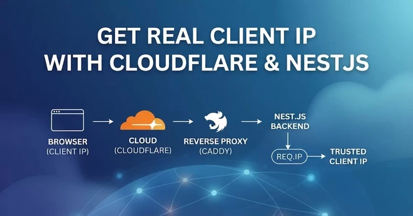

If your NestJS application sits behind Cloudflare, Caddy, a load balancer, or another reverse proxy, req.ip may not be the actual user's IP.
The problem is usually not the GeoIP database or the IP lookup library. The real issue is that your application is looking at the wrong layer of the network.
For example, your production request path might look like this:
Browser → Cloudflare → Caddy → NestJS
The NestJS server is not directly connected to the browser. It is connected to Caddy. Caddy is connected to Cloudflare, and Cloudflare is the layer that directly receives the user's request.
That distinction matters for everything from GeoIP lookups to rate limiting and security logs.
The key rule is simple: never trust a forwarded IP just because it appears in a header. Trust it only when it comes from a proxy you actually trust.

The Real Problem Is the Trust Chain
Consider this request:
Browser
Cloudflare
Caddy
NestJS
Suppose the real client IP is:
Cloudflare receives the connection directly from the user and therefore knows the original client IP.
Cloudflare then connects to Caddy.
Caddy connects to NestJS.
By the time the request reaches NestJS, the application is several network layers away from the original client.
The application therefore needs a reliable way to reconstruct the original client IP from information supplied by trusted infrastructure.
This is why simply choosing the first or last IP in a forwarded header is not a universal solution.

IP Headers Represent a Proxy Chain
With multiple proxies, X-Forwarded-For can contain several addresses.
For example:
X-Forwarded-For: 197.40.x.x, 203.0.113.10, 198.51.100.20 If your infrastructure looks like this:
Browser
Cloudflare
Load Balancer
Caddy
NestJS
then the application may receive information representing several proxy hops.

Your application should know something like:
rather than assuming:
Browser → NestJS
If you add another load balancer later, the trust model may need to change as well.
