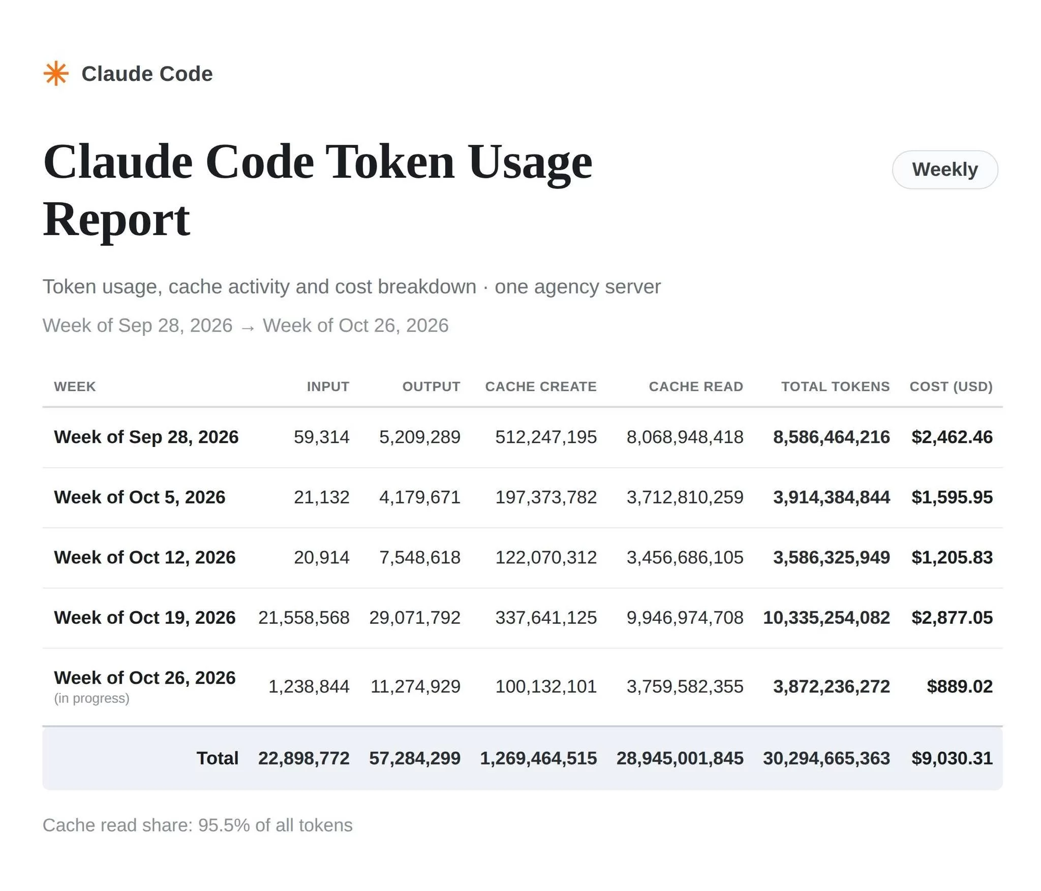

That's approximately 30.3 billion tokens, with nearly all reported token activity coming from cache reads.
The team used Claude's $200 monthly Max 20x subscription rather than paying for every request through a separately billed API workflow.
One important distinction: the $9,030 figure represents an estimated API-equivalent cost, not an actual bill or guaranteed savings. Subscription pricing and API billing are different models, and Claude subscriptions have usage limits.
Also, the reporting period covers 31 calendar days, so the exact subscription charges for that period depend on the billing dates.

28,945,001,845 cache read tokens out of 30,294,665,363 total reported tokens.
That represents approximately 95.5% of the reported token activity.
In other words, the overwhelming majority of the measured tokens came from previously cached content.
This doesn't mean that 95.5% of the total API bill disappeared. Cache creation, uncached input, and output tokens have different pricing.
It does indicate that the team's workflow achieved extensive context reuse.

📊 Claude Code Usage: $200 vs. $9,030
According to a usage report generated with ccusage, the team recorded the following activity between September 28 and October 28:| Metric | Reported Value |
| Reporting period | September 28 - October 28 |
| Total tokens | 30,294,665,363 |
| Cache read tokens | 28,945,001,845 |
| Cache read percentage | 95.5% |
| Estimated API cost | $9,030.31 |
| Monthly subscription | $200 |
Still, the report reveals something worth understanding: efficient context reuse can dramatically change the economics of AI-assisted development.

Why the 95.5% Cache Read Ratio Matters
The most interesting number in the team's report isn't the total token count.It's this:
For developers who repeatedly work with large codebases, documentation, and persistent project instructions, this is an important efficiency metric.

2. Cache Creation Tokens
How much new content is being written into the cache?
3. Input and Output Tokens
How much uncached input is processed, and how much new content does the model generate?
4. Estimated Cost
What would the recorded usage cost under the pricing assumptions used by the reporting tool?
Remember that estimated API costs aren't necessarily equivalent to actual Claude subscription charges.
