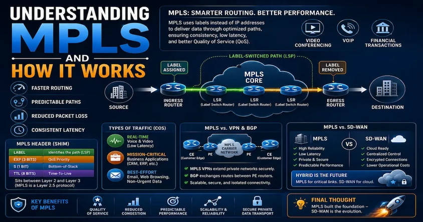

Multi-Protocol Label Switching (MPLS) is a high-performance data-carrying technique that speeds up and controls the flow of network traffic. Unlike traditional routing, which relies on IP addresses, MPLS uses labels to direct data packets through predetermined, optimized paths - ensuring consistency, low latency, and better Quality of Service (QoS).
It’s widely used by enterprises for applications requiring real-time performance, such as video conferencing, VoIP, and financial transactions.
Routers forward these packets across various networks until they reach their destination. However, traditional routing can cause delays because each router independently decides the next hop, leading to variable paths and inconsistent latency - especially for time-sensitive apps.
That’s where MPLS comes in.
The first router - called the ingress router - tags the packet with a label. As the packet moves through the network, each MPLS-enabled router (called an LSR or Label Switch Router) reads the label and forwards the packet along a predefined Label-Switched Path (LSP).
Since all packets in the same class follow the same LSP, MPLS delivers:
✅ Faster routing
✅ Predictable paths
✅ Reduced packet loss
✅ Consistent latency
Because this header sits between the data-link and network layers, MPLS is often called a Layer 2.5 protocol - combining the speed of Layer 2 with the intelligence of Layer 3.
By prioritizing packets, MPLS guarantees reliability where it matters most.

How Data Travels Across a Network
When data moves from one device to another, it’s divided into small packets. Each packet carries a header containing information about its origin, destination, and routing path.Routers forward these packets across various networks until they reach their destination. However, traditional routing can cause delays because each router independently decides the next hop, leading to variable paths and inconsistent latency - especially for time-sensitive apps.
How MPLS Works
With MPLS, packets are assigned labels instead of relying solely on IP addresses. These labels determine a specific Forwarding Equivalence Class (FEC), grouping packets with the same destination and service requirements.The first router - called the ingress router - tags the packet with a label. As the packet moves through the network, each MPLS-enabled router (called an LSR or Label Switch Router) reads the label and forwards the packet along a predefined Label-Switched Path (LSP).
✅ Faster routing
✅ Predictable paths
MPLS Header Explained
Each MPLS packet carries a shim header between Layer 2 and Layer 3, containing:- Label - Identifies the path (LSP) for forwarding.
- Experimental bits (Exp) - Used for QoS priority.
- Bottom-of-Stack (S) - Indicates the last label in a stack.
- Time-To-Live (TTL) - Defines how many hops a packet can make.
Types of MPLS Traffic Classes
Enterprises often categorize traffic using Classes of Service (CoS) to ensure high performance for critical applications:- Real-Time: Voice and video (low latency)
- Mission-Critical: Business apps like CRM
- Best-Effort: Non-urgent data such as email
MPLS vs. VPN and BGP
MPLS and VPNs often work together to create secure and efficient private networks.- MPLS VPNs extend private networks over shared infrastructure while maintaining isolation from public internet traffic.
- BGP (Border Gateway Protocol) is often used with MPLS for dynamic route exchange between Provider Edge (PE) routers.
MPLS and SD-WAN: The Evolution
While MPLS has long been the gold standard for reliability and performance, modern businesses are shifting toward SD-WAN.SD-WAN (Software-Defined Wide Area Network) offers similar benefits - like traffic prioritization and path optimization - but adds:
- Cloud readiness 🌩️
- Real-time centralized control
- Encrypted connections over broadband or LTE
- Lower operational costs
Key Benefits of MPLS
- Guaranteed Quality of Service (QoS)
- Reduced network congestion
- Predictable and consistent performance
- Enhanced scalability and reliability
- Secure, private data transport
