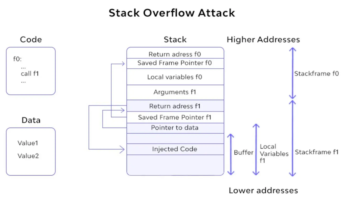

How Buffer Overflow Works Step by Step 🔍​
Understanding the internal process is key to exploitation.
Here’s what usually happens:
1️⃣ The program allocates a fixed-size buffer
2️⃣ User-controlled input exceeds the buffer size
3️⃣ Extra bytes overwrite nearby memory
4️⃣ Return addresses or function pointers get corrupted
5️⃣ Attacker gains control over execution flow 🚀
Once execution flow is controlled, code execution is just a matter of technique.

Stack-Based Buffer Overflow Explained ⚔️​
Stack-based buffer overflows are the most famous type.
Attackers typically:
  • Overflow a stack buffer
  • Overwrite the saved return address
  • Redirect execution to attacker-controlled code
Classic exploitation flow:
[ Buffer ][ Padding ][ Return Address ][ Payload ]
If protections are weak or bypassed, this leads to instant shell access 💀.
