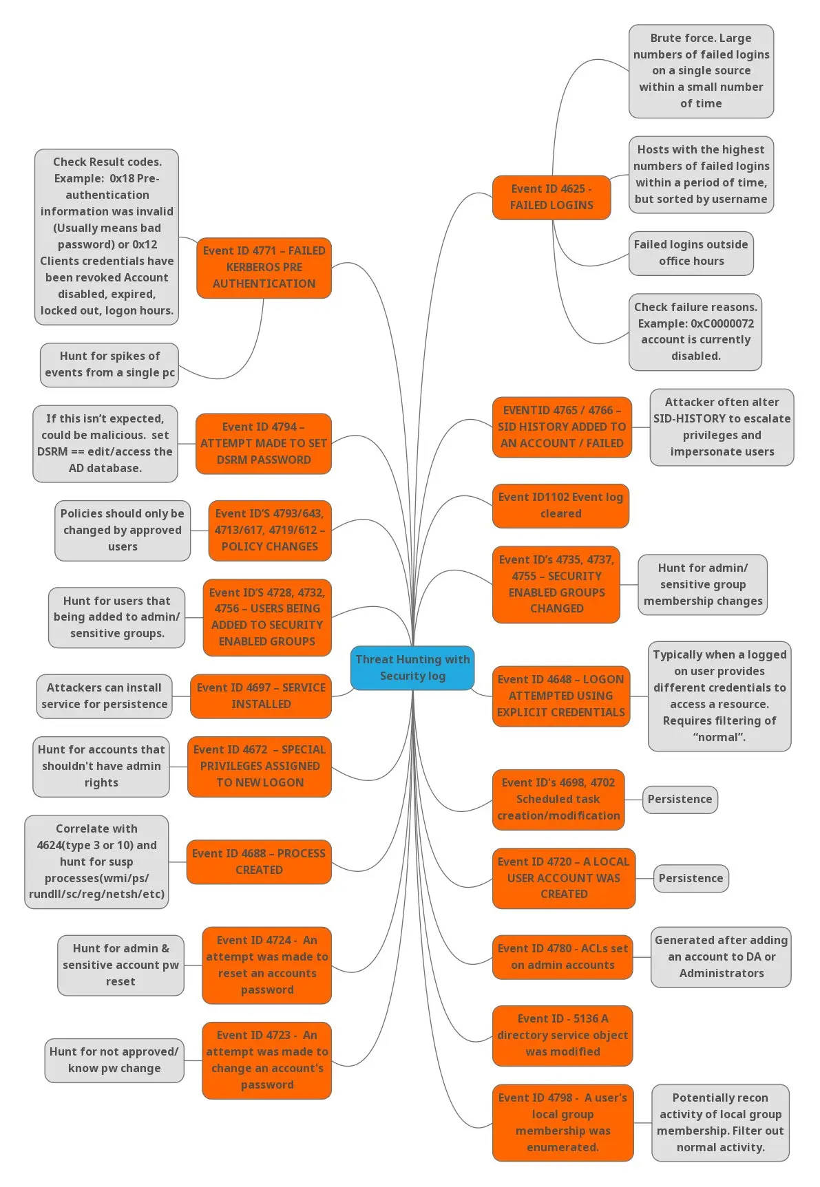

Important Windows Event IDs You Must Monitor 🔎​
Failed Logons - Event ID 4625 🚨​
This event is key for detecting:
  • Brute force attacks
  • Credential stuffing
  • Login attempts outside business hours
🔔 A high number of failures from one IP in a short time is a red flag.
Kerberos Pre-Authentication Failed - Event ID 4771 🔐​
Usually indicates:
  • Wrong password attempts
  • Locked or expired accounts
  • Password guessing attacks
⚠️ Repeated failures from the same host may signal an active attack.
Process Creation - Event ID 4688 ⚙️​
One of the most powerful events for Threat Hunting.
Helps detect:
  • Malicious PowerShell usage
  • Suspicious commands
  • Living-off-the-land attacks (LOLBins)
📌 Always correlate it with Event ID 4624 (successful logon).
Security Log Cleared - Event ID 1102 🧹​
🚩 Extremely suspicious event.
Attackers often clear logs to hide their tracks after compromise.
Service Installed - Event ID 4697 🧬​
Indicates:
  • New service installation
  • Potential persistence technique
👀 Always verify service name, path, and creator.
Scheduled Task Created - Event ID 4698 ⏰​
Commonly abused for:
  • Malware persistence
  • Backdoor execution
If the task is not approved → investigate immediately.
Local User Account Created - Event ID 4720 👤​
This event shows:
  • New local account creation
  • Possible unauthorized access setup
🚨 High risk if created outside maintenance windows.
Security Group Membership Changed - Event IDs 4728 / 4732 🔑​
Indicates:
  • User added to privileged groups
  • Possible privilege escalation
Always review Administrators and other sensitive groups.
