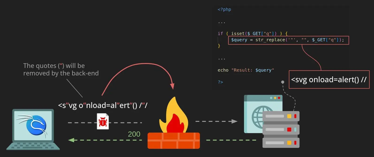

While hunting bugs in a real-world bug bounty program, I discovered a dangerous XSS bypass caused by weak input filtering.
The backend logic was only removing double quotes ("), which is a very common mistake developers make when trying to block XSS attacks.
This kind of protection may look safe at first, but in reality, it’s extremely fragile ❌.
However, modern browsers are very flexible when parsing HTML, which allows attackers to bypass such filters easily 😈.
Here’s the original payload that was sent:
After the backend removed all quotes, the payload became:
And just like that… XSS was successfully executed 🎯
Common problems with weak filtering:
✅ Always use proper encoding and security controls
If you’re a developer, weak filters can expose your users.
If you’re a penetration tester or bug bounty hunter, this type of logic flaw is pure gold 🪙.
🔍 How the XSS Bypass Worked
The application tried to sanitize user input by stripping quotes only, assuming that would stop JavaScript execution.However, modern browsers are very flexible when parsing HTML, which allows attackers to bypass such filters easily 😈.
<s"vg o"nload=al"ert() />After the backend removed all quotes, the payload became:
<svg onload=alert()>And just like that… XSS was successfully executed 🎯
