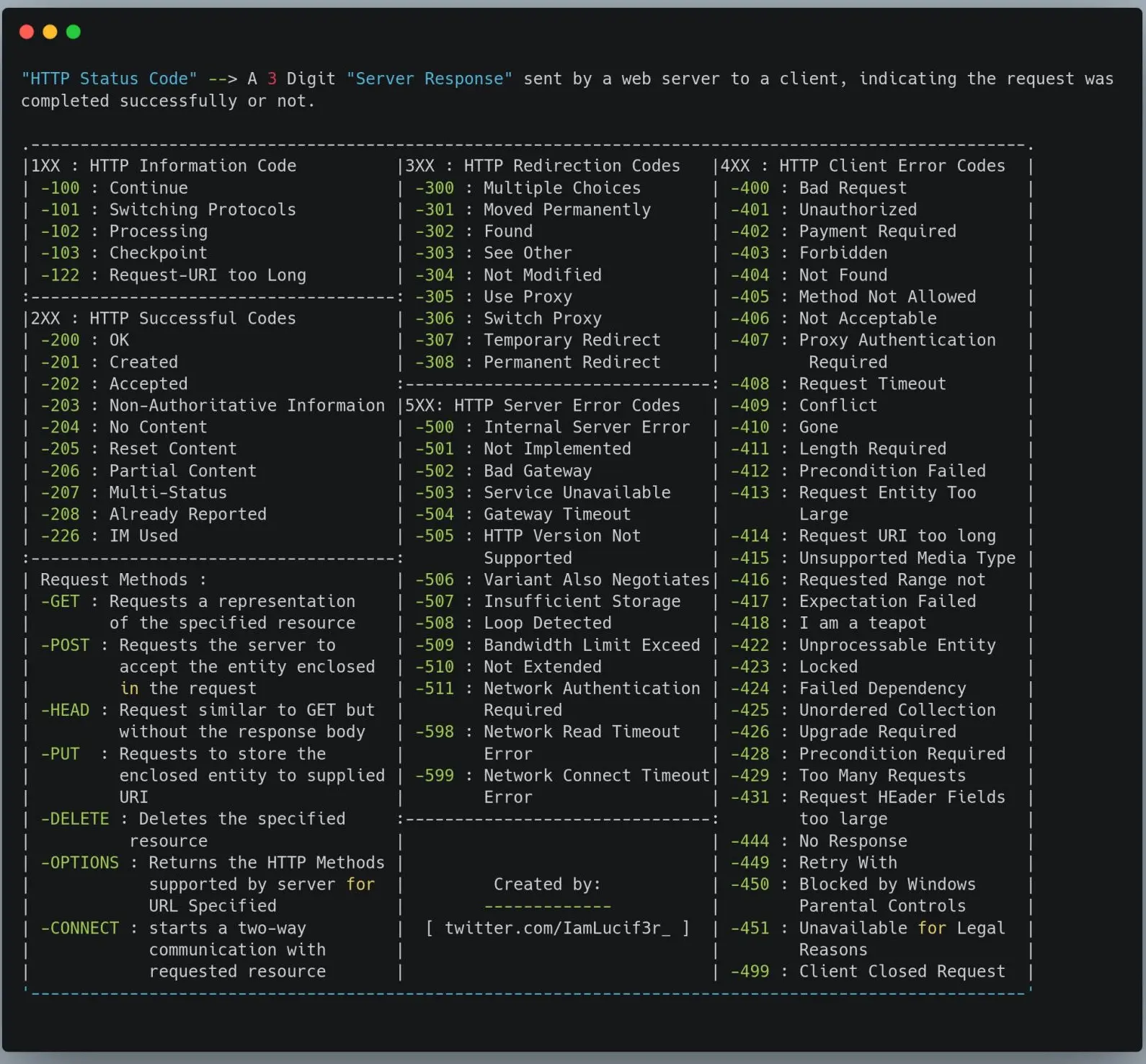

HTTP status codes tell you what happened to your request. They’re divided into five main categories:
  • 1xx - Informational: The request is received and being processed.
  • 2xx - Success:Everything went well! For example:
    • 200 OK: Request succeeded.
    • 201 Created: A new resource was created (e.g., after a POST).
  • 3xx - Redirection:You’re being redirected somewhere else.
    • 301 Moved Permanently or 302 Found are common.
  • 4xx - Client Error:Something’s wrong with your request.
    • 400 Bad Request or 404 Not Found (the most famous one 😅).
  • 5xx - Server Error:The issue is on the server side.
    • 500 Internal Server Error or 503 Service Unavailable.
Common HTTP Methods 🧩​
Methods tell the server what kind of action you want to perform:
  • GET: Retrieve information from a server (e.g., load a web page).
  • POST: Send data to the server (like submitting a form).
  • PUT: Update or replace an existing resource.
  • DELETE: Remove a resource from the server.
  • HEAD: Like GET, but returns only headers (useful for testing).
  • PATCH: Partially update a resource.
