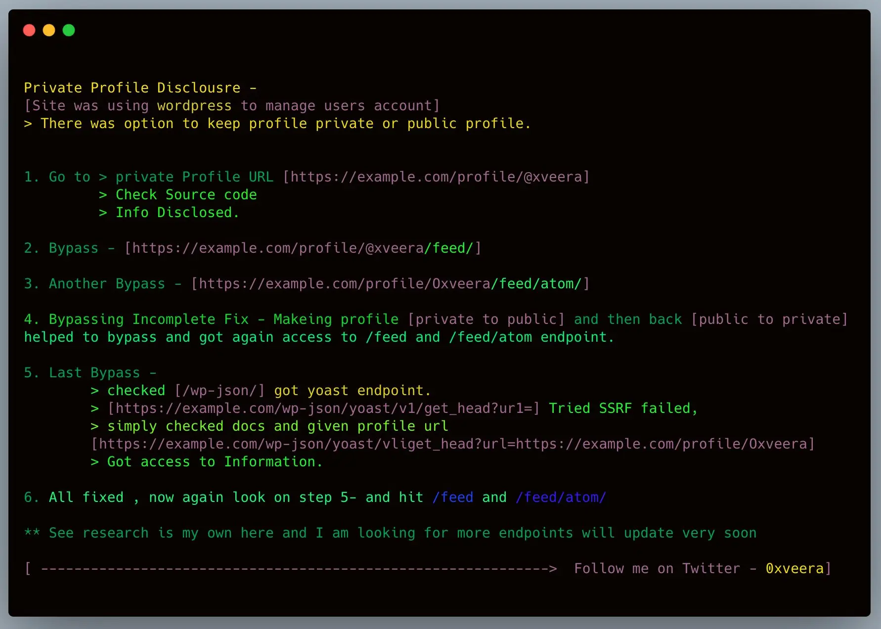

🔎 Common Bypass Techniques Used by Attackers
Here are some real-world bypass methods used to access private profiles 🚨:1️⃣ Viewing Page Source
Sometimes private profile data is still loaded in HTML comments or hidden fields. Code:
<!-- user_email: admin@example.com --> 2️⃣ RSS Feed Bypass
Private profiles may still have active feeds: Code:
https://example.com/profile/username/feed/ 3️⃣ Atom Feed Bypass
Another common endpoint that leaks data: Code:
https://example.com/profile/username/feed/atom/ 4️⃣ Incomplete Privacy Fix Issue
Changing profile visibility from private → public → private may reopen feed access again 🔁.This is a known logic flaw in some themes and plugins.
🧠 REST API & Yoast Endpoint Exposure
Many WordPress sites expose data using the REST API without strict validation ⚠️.Example using Yoast SEO endpoint:
GET /wp-json/yoast/v1/get_head?url=https://example.com/profile/username 🛡️ How to Protect WordPress from Profile Disclosure
