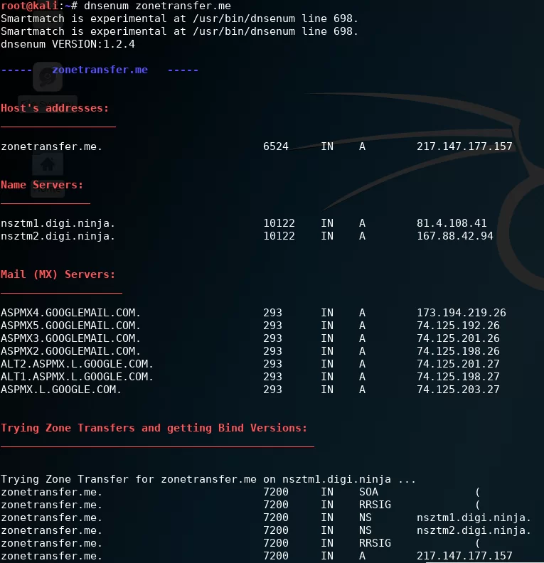

Kali already includes dnsenum in the official repositories. Just run:
sudo apt install dnsenum
