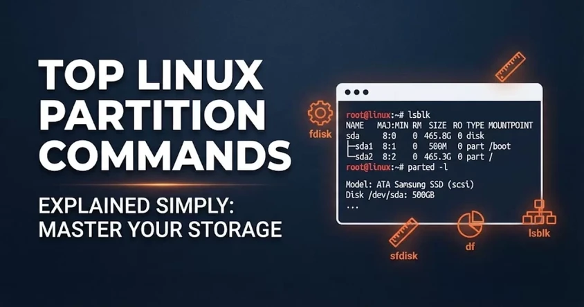

Top Linux Partition Commands Explained Simply
Managing and monitoring your storage devices is an essential skill for every Linux user. Whether you’re fixing errors, creating new partitions, or just curious about your system setup, Linux gives you many built-in commands to get the job done. 🧠
In this guide, you’ll learn the top commands to view partitions, file systems, and disk usage on Linux - with simple examples for each one.

💾 7. lsblk - List Block Devices Clearly​
lsblk lists all storage blocks, including disks, partitions, and optical drives.
lsblk
✅ Output:
NAME   MAJ:MIN RM   SIZE RO TYPE MOUNTPOINT
sda      8:0    0 465.8G  0 disk
├─sda6   8:6    0  97.7G  0 part /
└─sda8   8:8    0 198.5G  0 part /media/data
Show more info (UUIDs and model names):
lsblk -o PATH,SIZE,TYPE,MOUNTPOINT,UUID,MODEL
🚀 Best all-in-one command for quick storage overviews.
