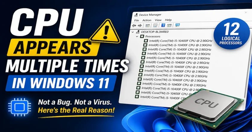

Ever opened Device Manager in Windows 11 and noticed your processor listed 8, 12, or even 16 times? 😅
A lot of users think this is a bug, a driver issue, or even a virus - but that’s not the case at all.
This is actually normal behavior, and it’s directly related to how modern CPUs and Windows handle processing power.
🧠 Physical Cores vs Logical Processors (Threads)​
Windows doesn’t just show your “physical CPU.” Instead, it displays something called Logical Processors (Threads).
Let’s take an example:
A CPU like Intel Core i5-10400F includes:
  • 6 Physical Cores 🧩
  • 12 Threads (Logical Processors) ⚙️
This happens because of a technology called Hyper-Threading.
👉 Each physical core can handle 2 threads at the same time (in most cases), so Windows sees them as separate processing units.

🛑 Is This a Problem or a Virus?​
No, not at all ❌
Seeing your CPU listed multiple times means:
  • ✅ Hyper-Threading is enabled
  • ✅ Windows is detecting your CPU correctly
  • ✅ Your system is using full performance capability
So there’s nothing wrong with your PC.

Better place to check CPU details:​
Open Task Manager → Performance → CPU
There you’ll see:
  • Cores = real physical cores
  • Logical processors = total threads
You can also verify with a simple command:
wmic cpu get NumberOfCores,NumberOfLogicalProcessors
