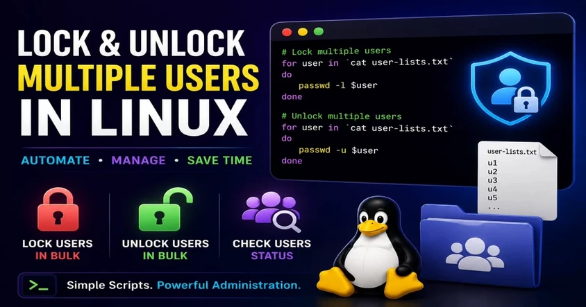

Managing multiple user accounts on Linux can get messy - especially when you need to lock or unlock many at once. Thankfully, with a few simple shell scripts, you can automate this entire process! 🚀
Let’s break it down step by step 👇
While both commands can handle one user at a time, you can write small shell scripts to automate them for multiple users simultaneously.
Make it executable:
Then run it:
✅ Output Example:
Make it executable:
Run it:
If you see
To unlock all users again, use this script:
Make it executable:
Run it:
✅ Output Example:
Now check again using the status script - if you see
💡 Pro Tip: Keep your scripts secure and executable only by authorized admins.
💬 Got any questions or suggestions? Drop a comment below - let's geek out together! 😎🐧

Preparing the User List 🧾
Create a text file nameduser-lists.txt that contains all the usernames you want to lock or unlock - one per line: Bash:
$ cat user-lists.txt
u1
u2
u3
u4
u5 1️⃣ Lock Multiple Users in Linux
Here’s a simple shell script to lock multiple accounts: Bash:
# user-lock.sh
#!/bin/bash
for user in `cat user-lists.txt`
do
passwd -l $user
done Bash:
chmod +x user-lock.sh Then run it:
sh user-lock.sh ✅ Output Example:
Locking password for user u1.
passwd: Success
Locking password for user u2.
passwd: Success
... 2️⃣ Check Locked User Status 🔎
Want to confirm if users are locked? Use this script: Bash:
# user-lock-status.sh
#!/bin/bash
do
passwd -S $user
done Bash:
chmod +x user-lock-status.sh Run it:
sh user-lock-status.sh If you see
LK next to the username, it means the account is locked 🔒 Code:
u1 LK 2025-10-20 0 99999 7 -1 (Password locked.) 3️⃣ Unlock Multiple Users in Linux 🔓
# user-unlock.sh
#!/bin/bash
do
passwd -u $user
done Bash:
chmod +x user-unlock.sh Run it:
sh user-unlock.sh ✅ Output Example:
Unlocking password for user u1.
passwd: Success
... PS, it means the account is unlocked 🔓 Code:
u1 PS 2025-10-20 0 99999 7 -1 (Password set, SHA512 crypt.) 🎯 Conclusion
With just a few shell scripts, you can efficiently lock, unlock, and verify multiple Linux accounts without manually handling each one.💡 Pro Tip: Keep your scripts secure and executable only by authorized admins.
