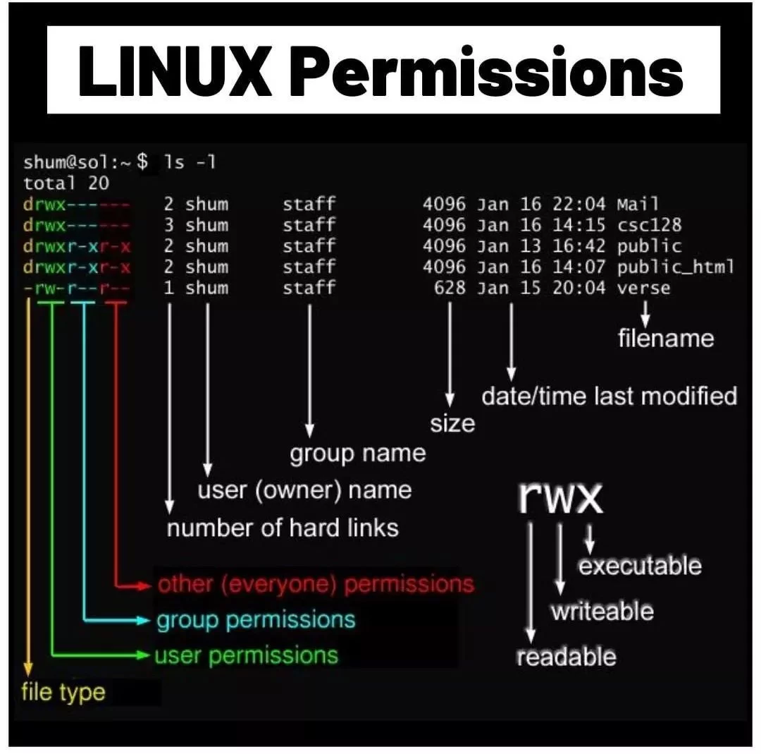

Example: drwxr-xr--
Let’s break it down 👇
  • d → It’s a directory.
  • rwx → The owner can read, write, and execute.
  • r-x → The group can read and execute, but not write.
  • r-- → Others can only read.
So, drwxr-xr-- means the owner has full control, the group can view and enter, and others can only read.
