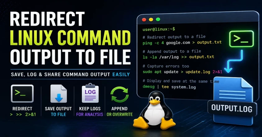

#1 Use redirection operators > and >> 🔁​
The simplest way to save output is with shell redirection.
  • > writes output to a file and replaces existing content.
  • >> appends output to the end of a file.
Examples:
# Replace file contents (create output.txt if missing)
ping -c 3 google.com > output.txt
# Append to file (keep previous results)
ping -c 3 bing.com >> output.txt
If output.txt does not exist, both commands create it. Using > will overwrite previous data -so be careful. Using >> is safer when you want to keep prior runs. ✅
Capture both stdout and stderr (errors) 2>&1 ⚠️​
Many commands print useful messages to stderr (error stream). To store both normal output and errors into the same file, append 2>&1:
# Append stdout and stderr to output.txt
some-command >> output.txt 2>&1
# Or overwrite file with both streams
some-command > output.txt 2>&1
Explanation:
  • 1 is stdout, 2 is stderr.
  • 2>&1 redirects stderr into stdout, then file redirection captures both.
This is vital for debugging scripts or long runs - you won’t miss hidden error lines. 🔍
#2 Use tee to display and save at the same time 🪣🔍​
If you want to see output live on the terminal while also saving it to a file, use tee. It reads stdin and writes to both stdout and a file.
# Save output to file and show it on screen
ls -la /var/log | tee files-list.txt
# Use append mode with -a
ls -la /var/log | tee -a files-list.txt
tee is great for interactive sessions or when you run a long command and want a log without losing the terminal output.
To capture both stdout and stderr with tee:
# Pipe both streams to tee
some-command 2>&1 | tee run.log
This writes everything to run.log while letting you watch the output live. Perfect for monitored scripts. 🎯
