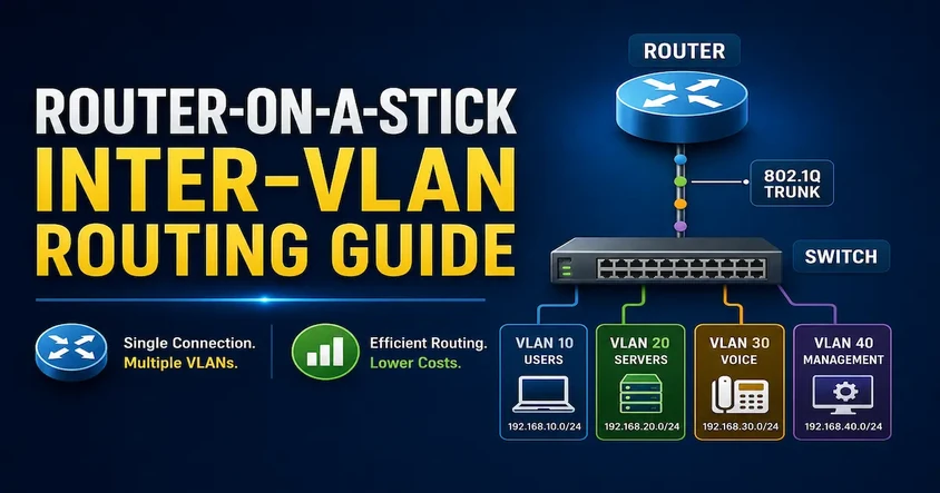

How Router-on-a-Stick Works​
In a traditional network design, each VLAN would require a dedicated router interface.
With Router-on-a-Stick, a single router interface handles traffic for multiple VLANs using:
  • One Physical Interface
  • Multiple Subinterfaces
  • An 802.1Q Trunk Link
  • VLAN Tagging
The switch sends VLAN-tagged traffic across a trunk connection, and the router processes each VLAN through its corresponding Subinterface.
Example Network Design 🌐​
Consider the following VLAN structure:
VLAN 10 - Users​
  • Network: 192.168.10.0/24
  • Default Gateway: 192.168.10.1
  • Router Subinterface: G0/0.10
VLAN 20 - Servers​
  • Network: 192.168.20.0/24
  • Default Gateway: 192.168.20.1
  • Router Subinterface: G0/0.20
VLAN 30 - Voice​
  • Network: 192.168.30.0/24
  • Default Gateway: 192.168.30.1
  • Router Subinterface: G0/0.30
VLAN 40 - Management​
This VLAN is typically used for:
  • Switch Management
  • Device Monitoring
  • Network Administration
  • Infrastructure Services
Each VLAN operates as its own broadcast domain, requiring routing services to communicate with other VLANs.
