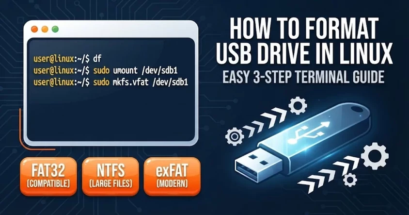

🔍 Step 1: Locate Your USB Drive​
First, open your terminal and type: df
This command lists all mounted drives and partitions - including used and available space.
Now, look for your USB drive in the list. It’ll look something like /dev/sdb1.
💡 Tip: If you’re not sure which one it is, unplug your USB stick, run df again, then plug it back in - the new device that appears is your USB drive!
💾 Step 2: Unmount and Format the USB​
Before formatting, you’ll need to unmount the drive so Linux can safely modify it.
sudo umount /dev/sdb1
Once it’s unmounted, you can choose your preferred file system type 👇
✅ Format as FAT32 (for compatibility with Windows & macOS)​
sudo mkfs.vfat /dev/sdb1
💽 Format as NTFS (for large files & Windows systems)​
sudo mkfs.ntfs /dev/sdb1
⚙️ Format as exFAT (best for USBs used on modern systems)​
sudo mkfs.exfat /dev/sdb1
💡 Replace /dev/sdb1 with your actual USB device path.
